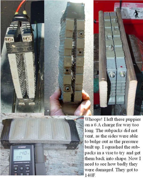

I have a lot of experience with the prius cells, and can assure you that heat and internal pressure is generated even at the low 350ma current. The prius cells flat sides make a great internal pressure indicator, and will begin to bulge outward just as the cells reach 100% SOC, pointing to a simple microswitch based charge terminator.
http://www.99mpg.com/blog/batterypac...subpacks.jpg,0
