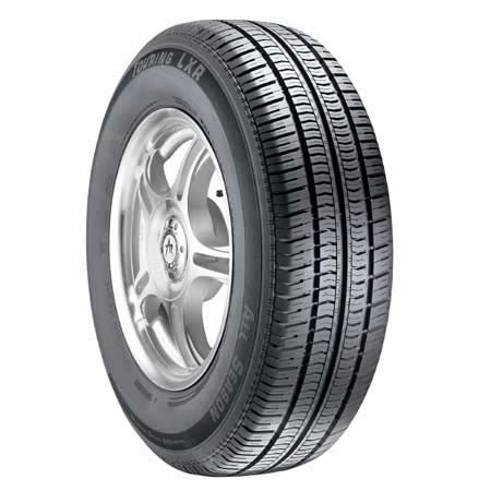

These tires look a lot like mine:
I do not think they are Low Rolling Resistance just by the weight of 15 pounds. You will have everything better, except for gas usage. You will loose some MPG if I am not mistaking.
