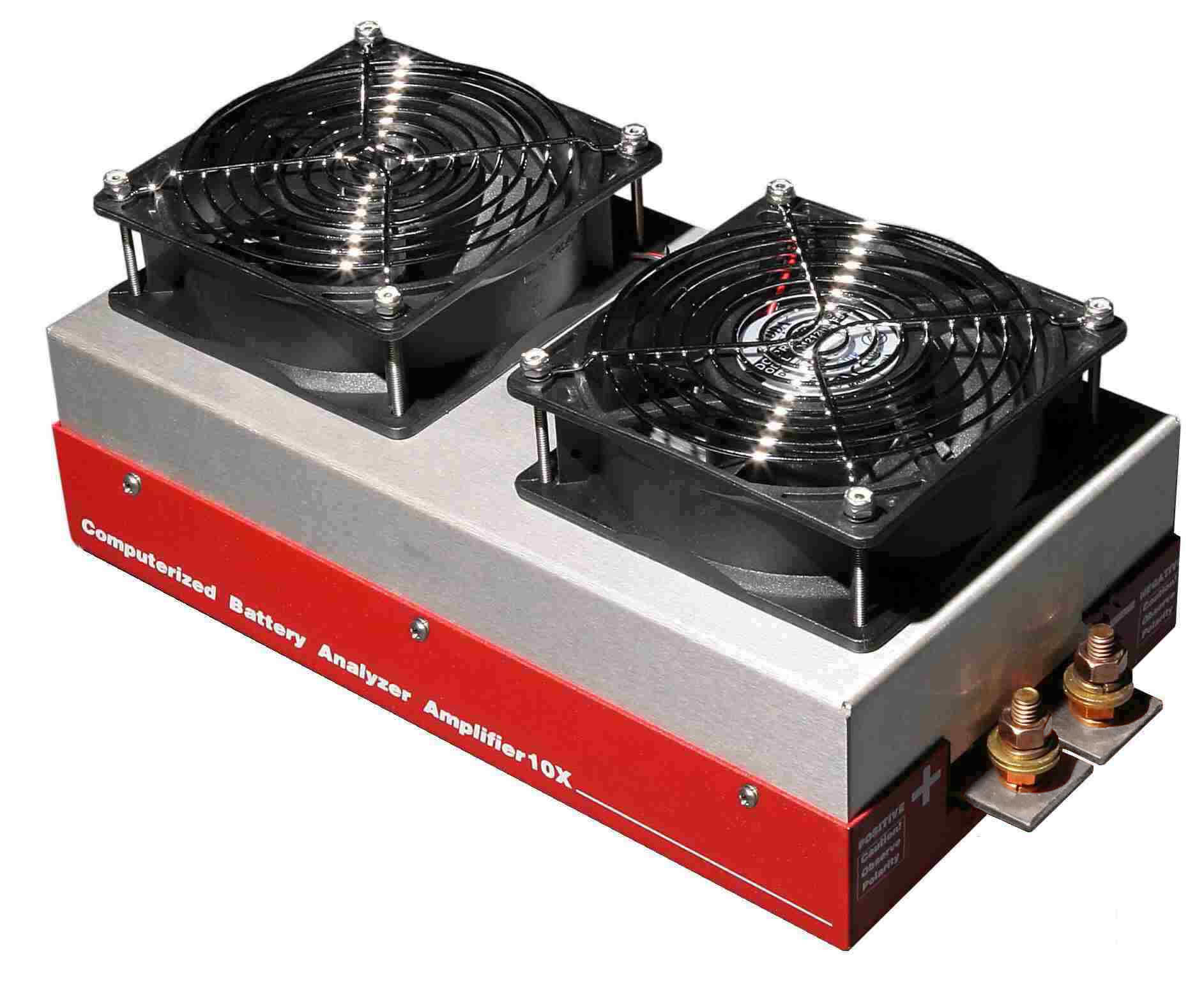

I actually have more than that, but I can only run about 30 of them on two 20 amp circuits because I also have to run pack fans. They're loud, but not nearly as loud as the monster fans on this foot long amplifier.
