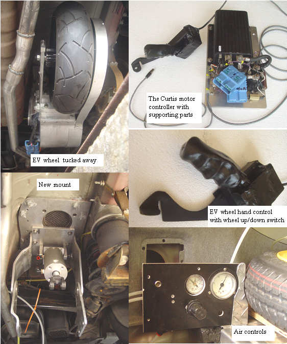

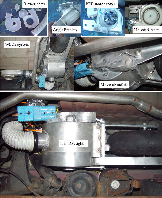

Some Photos and comments on the e-wheel
The Insight E-wheel after 3 years - MIMA Honda Insight Modified Integrated Motor Assist
Mike Dabrowski 2000 is offline   Reply With Quote

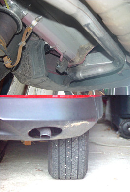

I'm really interested in your exhaust. Did you just unbolt the muffler from the cat, or do you have side-pipes? How loud is it?

The pictures of the wheel are impressive. Three years and it really doesnt look bad at all.
500 to 600 miles though is far less than I would have expected in three years of use.

On the exhaust, I removed the large final resonator buy cutting it right out, and I welded a specially shaped exhaust pipe to bypass the removed resonator.
http://www.99mpg.com/Projectcars/The...austpipe.jpg,0
and :
http://www.99mpg.com/Projectcars/The...mponents.jpg,0
and:
http://www.99mpg.com/Projectcars/The...omposite.jpg,0
At full power, all the way up to about 70 MPG, the exhaust is noticeable while driving, but fades to near silence as the MPG gets up in the 90+ range. Think of it like an audio feedback device, the better your MPG, the quieter the exhaust.
The loudest exhaust is when driving real hard at highway speeds, at less than 50 MPG.
I like the exhaust sound, it reminds me of my MPG, and of course made room for that tight fitting e-wheel.
