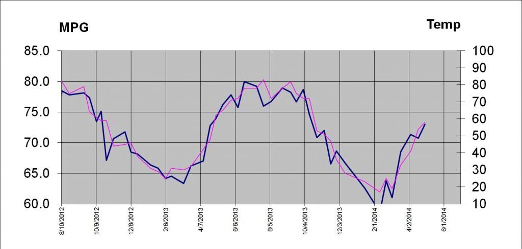

My mileage. Yours may vary. Pink is temperature, blue is MPG.
Damn dude.. I am continually impressed by the owners on this board..
Assuming all equivalent other than temperature, that is a great graph!!!
Thanks for sharing kind sir.
