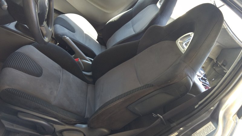

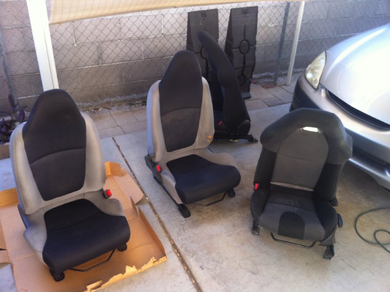

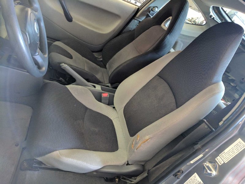

Got a late start and only got half the new seats installed. Spent lots of time grinding, cutting, and welding.
I should have it all done by tomorrow evening. They are RX8 seats in case anyone wonder.

$120 for both seats. I paid my friend $100 for helping me weld the brackets in.

aside from the rotor logo, they almost look like they were made for an insight. not to mention the recliner handle is in the correct place, they also have a seat base tilt function, that the insight doesn't have. the side supports hold you in place better too, since they were made for a sports sedan.

yes, they are quite comfortable for long distance driving or for taking your car to the track(and i don't mean slow course hypermiling track).

This is the template I used, adjust it for your use. Welding is require, bolt and nuts won't work. We used strip metal, and 1x2 metal tubes. I can take pictures later.

Seats together.

Did you need to use any of the parts from the Insight seats? I'm thinking of putting on the black and red leather rx-8 seats with power and heat and am wondering if I can sell the old seats or if they will be gutted to do the swap.
I did not need to use any parts from the insight seats. You will have to weld in the seat belt mounting points on the RX7 seats bracket.

So what did you think about the upgrade in ride comfort? Does it make the Insight a comfortable car to drive? Mine is extremely uncomfortable and makes my back hurt the next day.
