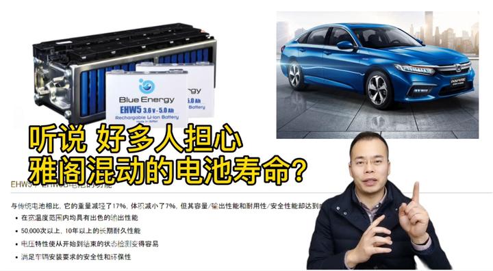

I've been trying to find more information about these batteries. Here are my findings thus far:
The best rabbit hole I've explored so far is from the serial number label that was attached inside the box... it contains the text "UF121285H". That leads to this website:
Findings from that website:
From Honda immd hybrid system, which is used in both 2018-2020 Accord Hybrid & 2019+ Insight
Chemistry: LiNiCoMnO2 (ternary lithium battery)
"Panasonic used after localization, model UF121285H". I think he means that the battery was originally designed by Blue Energy (which itself is 49% owned by Honda)... and now Panasonic is making the pack instead. Remember: the box that these modules shipped in has Panasonic written all over it, as do the various labels.
"At present, the detailed specifications of this battery of Panasonic are not available online, but because Honda directly replaces it, we have reason to believe that the specifications of the two batteries (Panasonic vs Blue Energy) are compatible."
"UF 12 12 85" is based on cell dimensions (120 x12 x 85 mm).
Cell information:
Model: EHW5
Ah: 5 (when charged to 4.2 volts)
Vnom: 3.6
Operating range: -30 degC to 55 degC (131 degF)
Cycle life: 50,000 (@10-85% SoC), continuous 40A charge/discharge!
Time Life: 10 years
Recommended charge/assist current: 200 A
Maximum charge/assist current: 300 A (60C)
Power density: 4.9 kW/kg
The reason the part number on the box doesn't pull up on Honda's website is that the pack itself is a non-user-purchasable subcomponent of the following parts:
1D070-6C2-305 (2018-2020) Accord Hybrid). OEM cost: $2762
1D070-6L2-A00 (2019 Insight Hybrid). OEM cost: $3126
So yeah, this $440 battery is ~$2800 from Honda.
