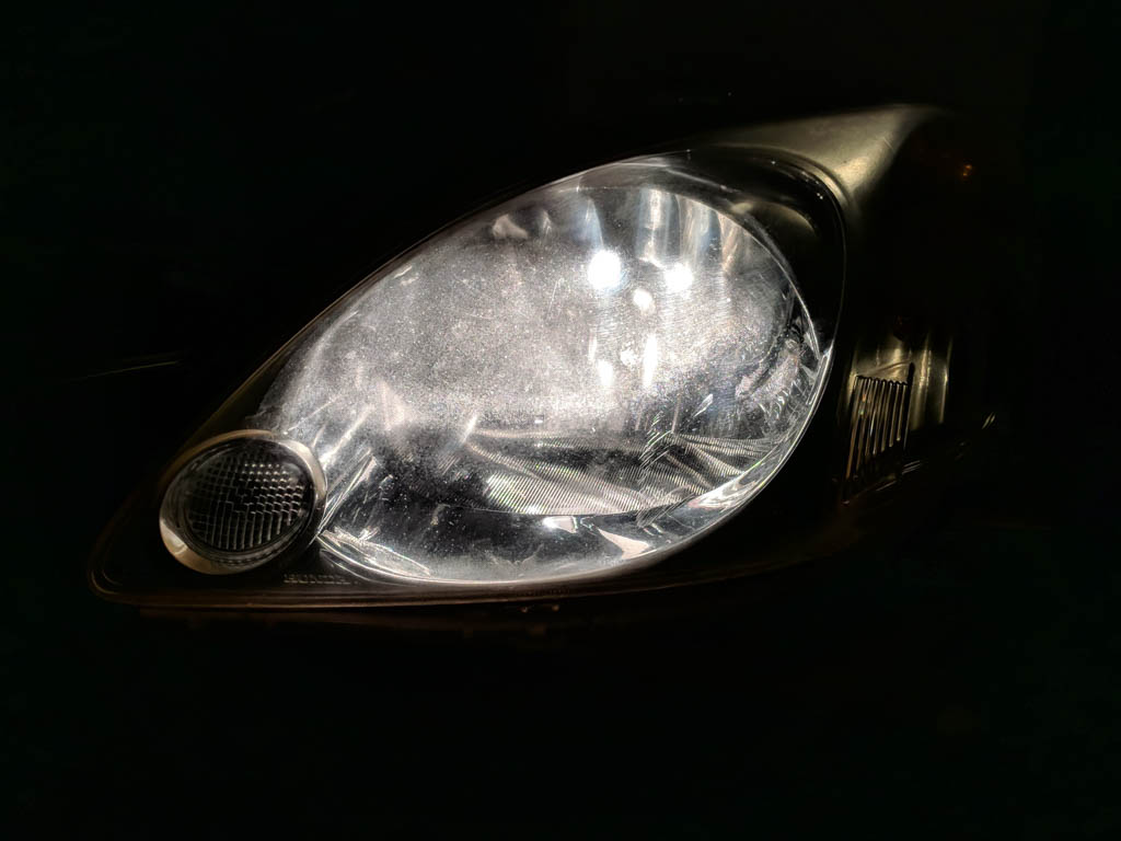

After sitting for over two years since the last polish, here is a halogen low beam from my 2006 Insight.
At first glance, it may not look too bad, but after 30 minutes of polishing, consider this:
With less light being scattered by the clearer lens, light output is dramatically improved. And, with the light from the halogen bulb now properly focused under the cutoff, the road will be better illuminated allowing you to see further.
As an added bonus, notice how much less light there is above the cutoff? This is good for everyone you share the road with as there will be less glare from your headlights. A win-win.

Here is a before and after pictures of the lens.
Clearer, but still room for improvement.
Hopefully it's clear how much better the light output is, even from a not-perfect polishing.
