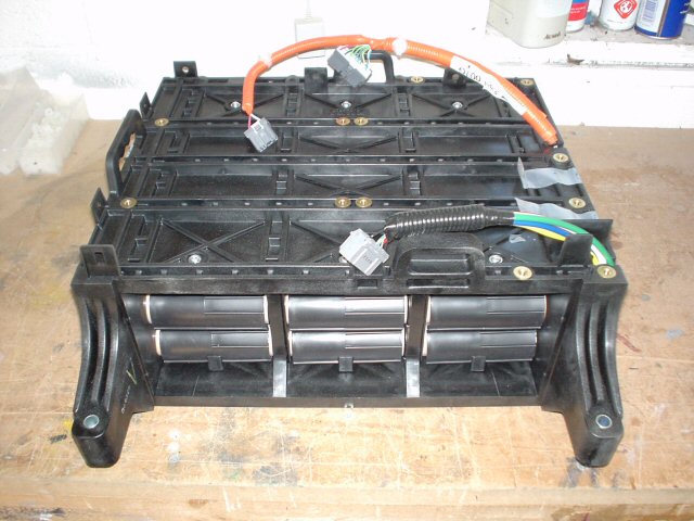

IMA Battery swap completed.
I have completed my IMA battery swap, no real issues, took about 2.5 hours. Been for a short trip and now showing charged to max capacity. Feels responsive and more lively, reset trip meter and showing 110mpg over last 10 miles. Some unedited photos are here.
http://www.solarvan.co.uk/insight/battery001.jpg
Just change the number on the end up to 033 to get the photos, all are about 500kb jpg unedited. The odd one is missing as they were out of focus or whatever. Just step to the next number if you get file not found.
Peter
