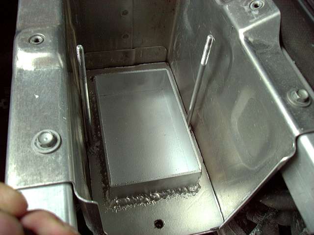

Because of the massive size difference, I fabricated an inner battery tray:
The tray is made of 4MM steel, two long bolts and two wingnuts. Excuse the slightly messy welding as I was having wire feed speeds (clogged tip, store was closed). A quick shot of generic aluminium paint matches the aluminium of the Insight.
Fitting the tray in the stock battery tray:
The stock battery tray is not exactly square, and it has raised sections near the bottom. So unfortunately it require some grinding to fit my tray in the car's. This ruined the paint around the edges, so I will have to repaint when the weather turns warm. Note the two drilled holes to bolt the tray in place. I could have gotten by with using some of the holes predrilled in the bottom of the battery tray, but I did not want to bother removing the tray to locate the holes on my tray adapter.
And the finished product:
I had to fabricate two 6" cables to adapt the screw type lugs on the battery with the post type the Insight is expecting. I'm not sure why I just didn't make the ground cable from scratch, but I will do so when the temperature outside increases past freezing.
