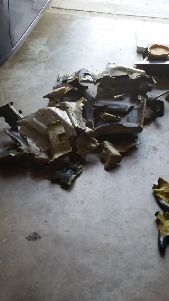

-tar-sound deadening removed (except under IMA battery)

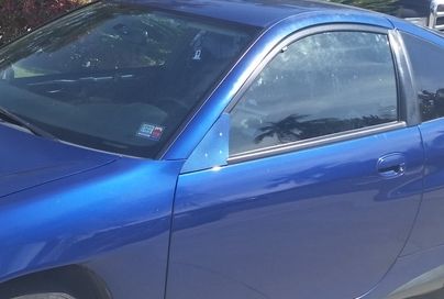

-side view mirrors removed/ mirrors inboard

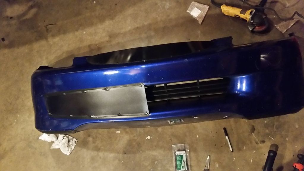

The lower grille block only covers the pass. side, thus the radiator side is fully open. My thinking was that because I've removed over 200 pounds from the car and reduced aero drag, my thermal load has also been reduced (less fuel in, less heat out). I did just receive a new temperature gauge with a water-proof probe and that will be installed soon to directly monitor the temperatures.

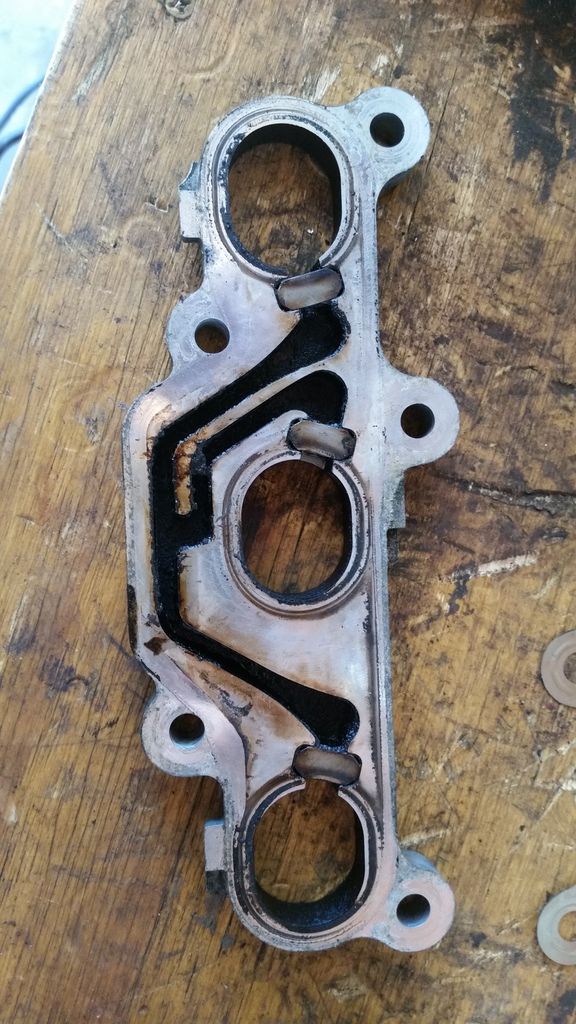

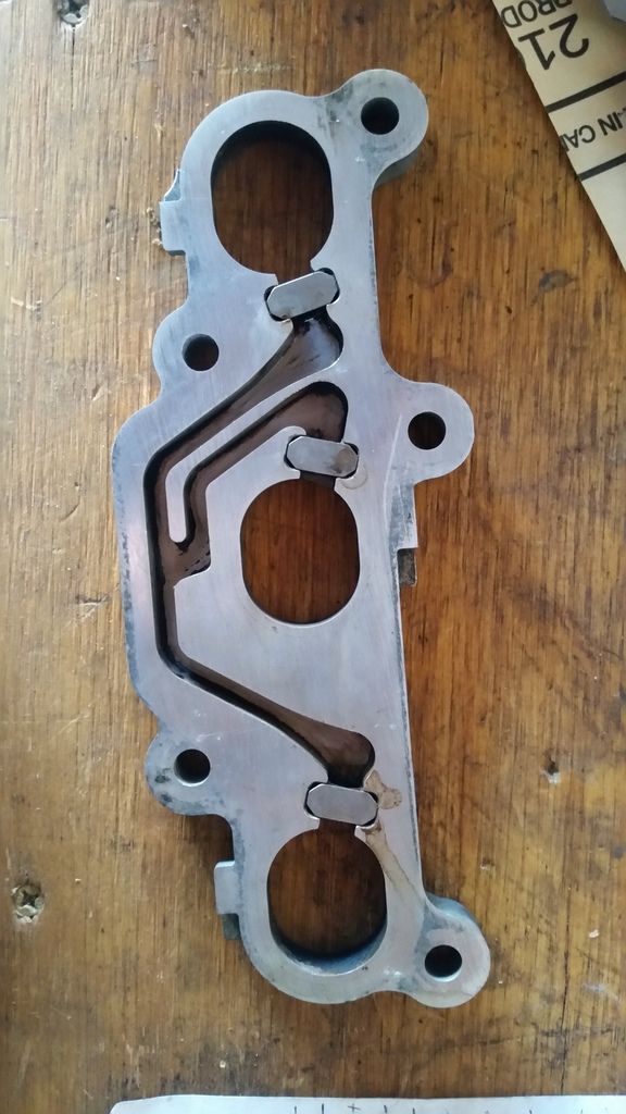

The exhaust paths on the intake after buying before and after cleaning

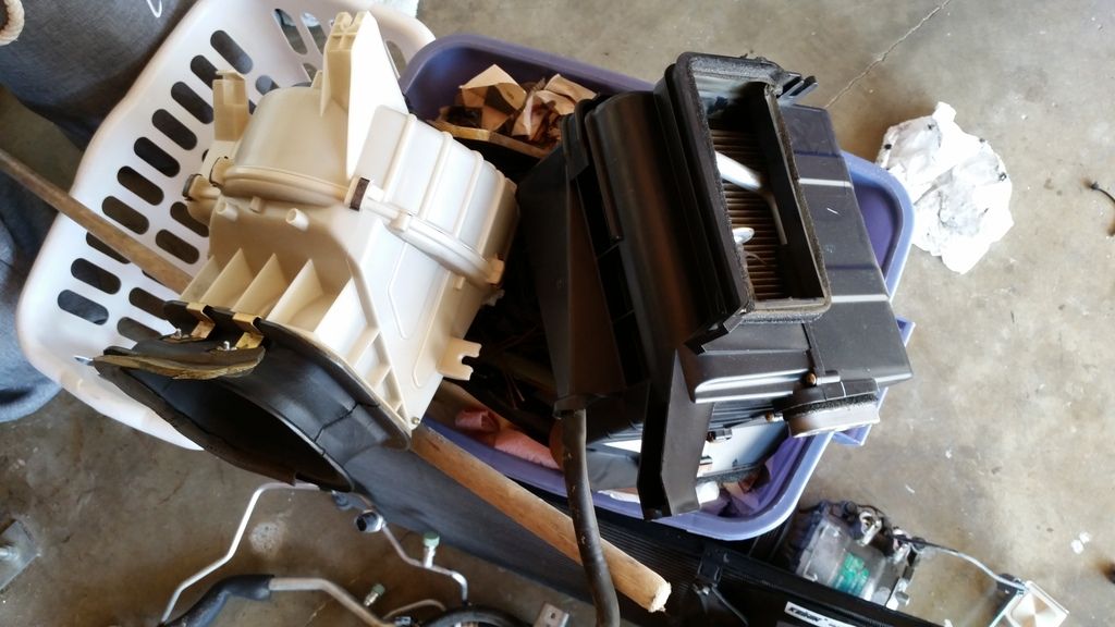

The worst day of my girlfriend's life summarized in the following photographs. A/C is just drag and dead weight!

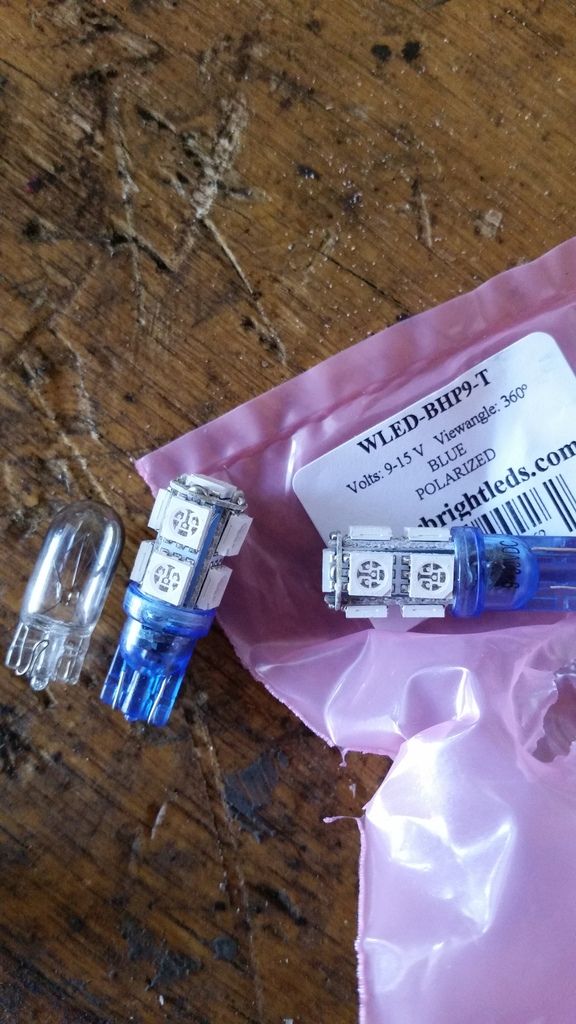

Took the grinder to the fasteners in the throttle body. Every little bit of drag on the air pump of a motor must go right? (more to show my friends how dedicated I am)

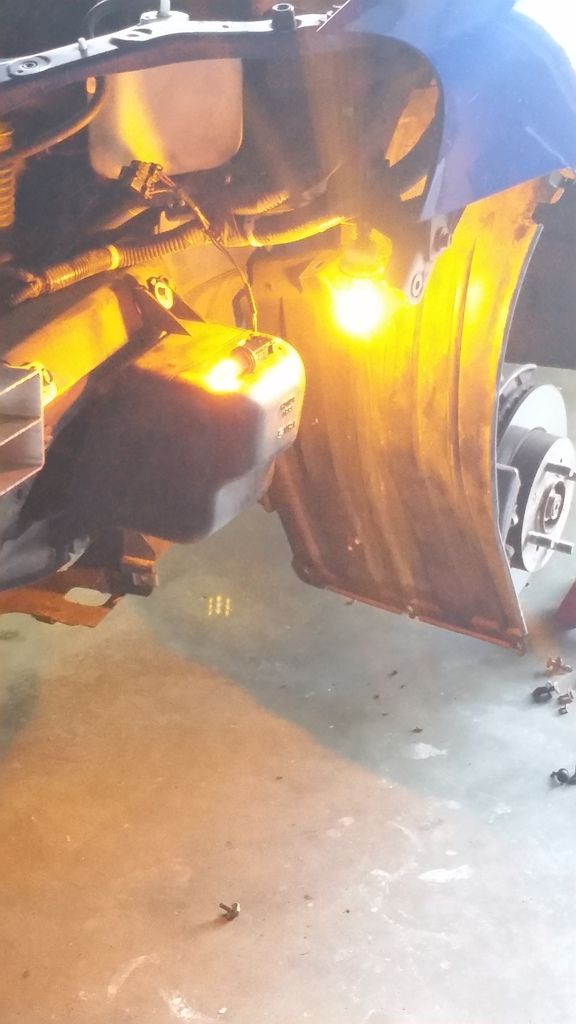

LED indicators/ running lights. Electrical power isn't free power. You will start to see the theme if you haven't already.

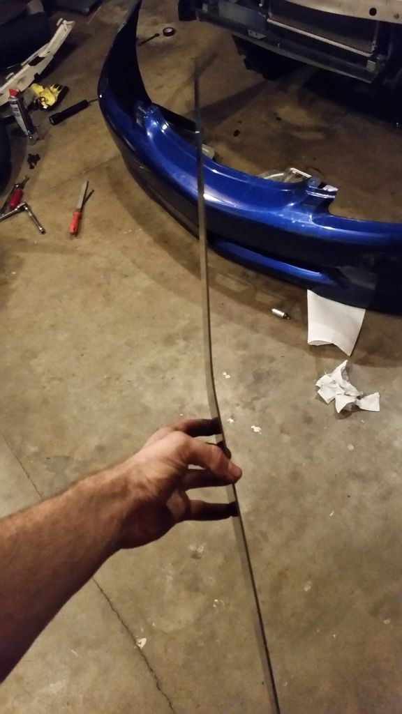

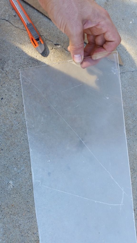

The air dams upper and lower are made from Lexan polycarbonate. Great against rock impacts from following cars on the highway.. Even better for not cracking while drilling like acrylic. Painted black to make them blend into the car. Retaining a "normal" looking car can be nice.
If you're wondering how they are secured to the front bumper: zip ties
The upper dam was given a bend to match the curve of the bumper. Preheat the oven at 250F and let bake 5-10 minutes or until the internal temperature is 165F before eating

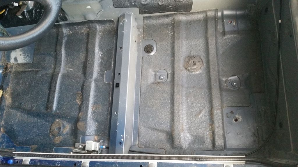

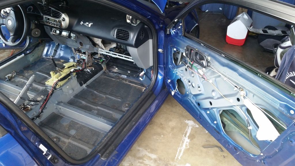

Lots of heavy sound deadening that is easily replaced with tiny in-ear foam cylinders (a few grams of dead weight a piece but some things can stay)

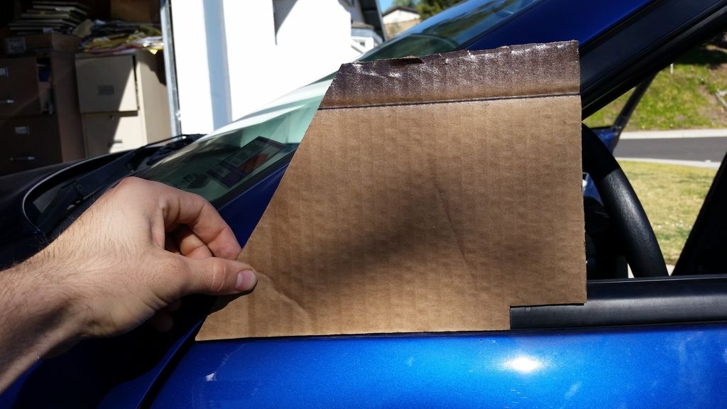

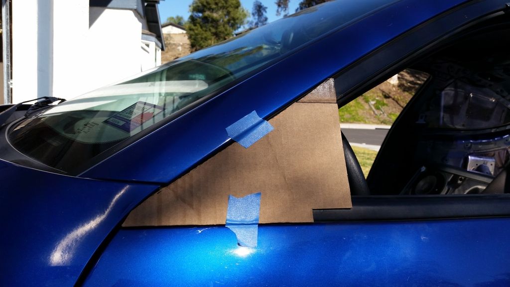

Auto-cad and Solidworks are expensive, cardboard isn't.
Be sure to test fit and make sure you can still open your door.
Once again Lexan shows it's usability

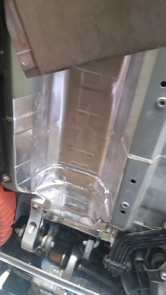

While I had the car up on jack stands slapped on some heat shielding in the exhaust tunnel. Not a necessity now, but eventually with the carbon underbody made the exhaust will need to be moved very close to the aluminum body. No a/c, plus any kind of external heat from burning gas, combined with hot california sun, equals a bad time and no girlfriend. I use DEI "Reflect a Cool" after good results with my Jeep. Adheres well. Not for conductive insulation

That ugly heater core has since been removed.

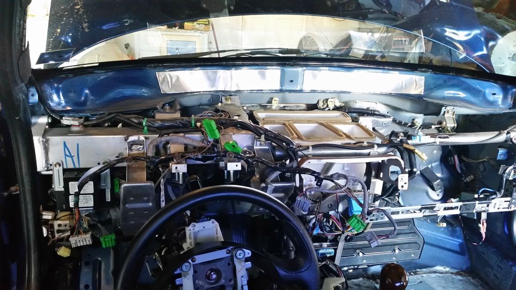

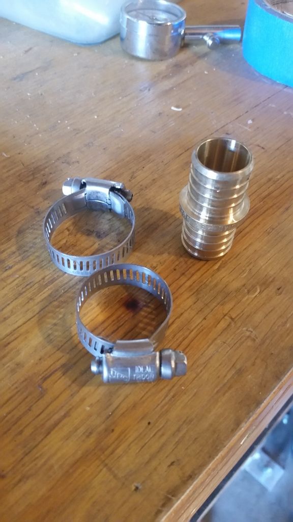

Speaking of removing your heater core here's how you bypass it without a welder. The hose flowing to the heater has an ID of 11/16" and the hose flowing back to the engine has an ID of 3/4". Kinda hard to find a hose with those sizes at each end to just slap on, so I went the next best route:
Get a regular old hose fitting and 2 clamps
Cut the old hoses down
And just bend them around and attach to the new fitting to close the loop.
I used Permatex Aviation Form-A-Gasket on the hose fitting as an extra precaution since I don't want coolant leaking out while the system is under pressure. No issues yet.
Pro tip** You can always just bend the smaller ID hose around and close the loop without the extra fitting.. Problem was space was tight and I couldn't get it to squeeze over the 3/4" barb, So I went this route. I think it adds under hood bling;)
Administrator
11,805 Posts
If you operate the car like that won't a lot of the water pump effort be wasted pumping hot coolant round that unrestricted loop bypassing the radiator. You could perhaps get a nasty hot spot in the head?
The heater coolant circuit had a valve so you could close it off.
It seems more sensible just to bung the two ports and force the coolant via the radiator for maximum cooling.
